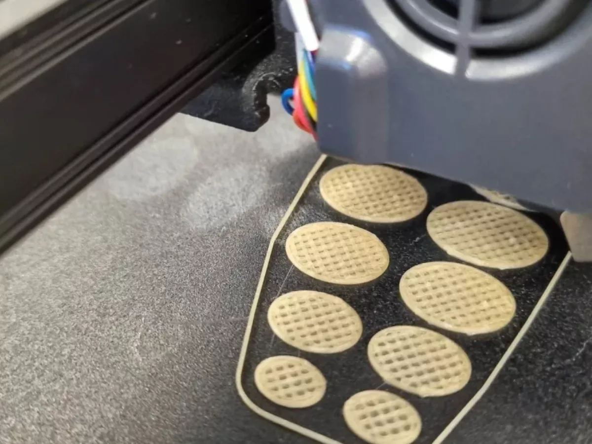

The printing of medicines uses the same technology, building a tablet one layer at a time by melting the medication combined with other approved ingredients to help it dissolve in the stomach. Importantly, the tablet can be 3D printed at any required dose by giving instructions to the machine to print it bigger or smaller.
In our proof of concept study we were able to 3D print tablets containing very accurate doses of caffeine, in a way that would be exceedingly difficult with conventional manufacturing methods.
Rather than choosing a dose based on limited commercial options, we selected the dose first and then designed and printed the tablet accordingly.

Compared to attempts to split a conventional caffeine tablet into the same doses, the 3D-printed tablets proved to have far more accurate dosage.
Our results demonstrate a straightforward process for producing “the right medicine for the right patient at the right time”. This is one of the guiding principles of personalised medicine.
