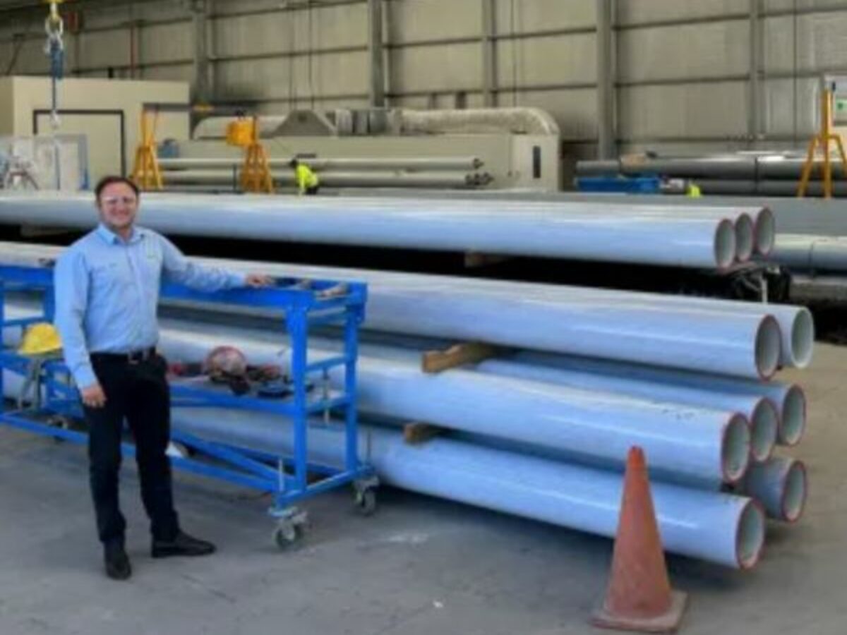

Wagners CFT National Product Specialist – Utilities James Lorrimer (pictured) said: “Wagners CFT has worked really hard to expedite the launch of its 356mm utility pole in answer to the call from network operators to find a solution, and quick.

Picture: Wagners Composite Fibre Technologies/National Product Specialist – Utilities, James Lorrimer with utility poles at Wagners CFT's Wellcamp manufacturing facility near Toowoomba, Queensland.
