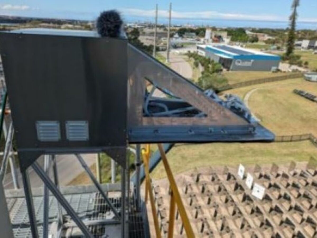

Hydrogen technology developer Sparc Hydrogen has successfully tested its second generation prototype photocatalytic water splitting (PWS) reactor atop a solar tower at the CSIRO Energy Centre in Newcastle, New South Wales (pictured).

According to Sparc, the performance of the reactor over a range of concentrated solar and thermal operating conditions was significantly improved compared to the first generation prototype, with better temperature and pressure control, gas production and measurement.
Hydrogen gas production was close to that which was estimated based on laboratory results using the same photocatalyst material, providing validation for laboratory testing under concentrated solar simulation.

Picture: Sparc Hydrogen/second generation prototype photocatalytic water splitting (PWS) reactor mounted on solar tower at CSIRO
