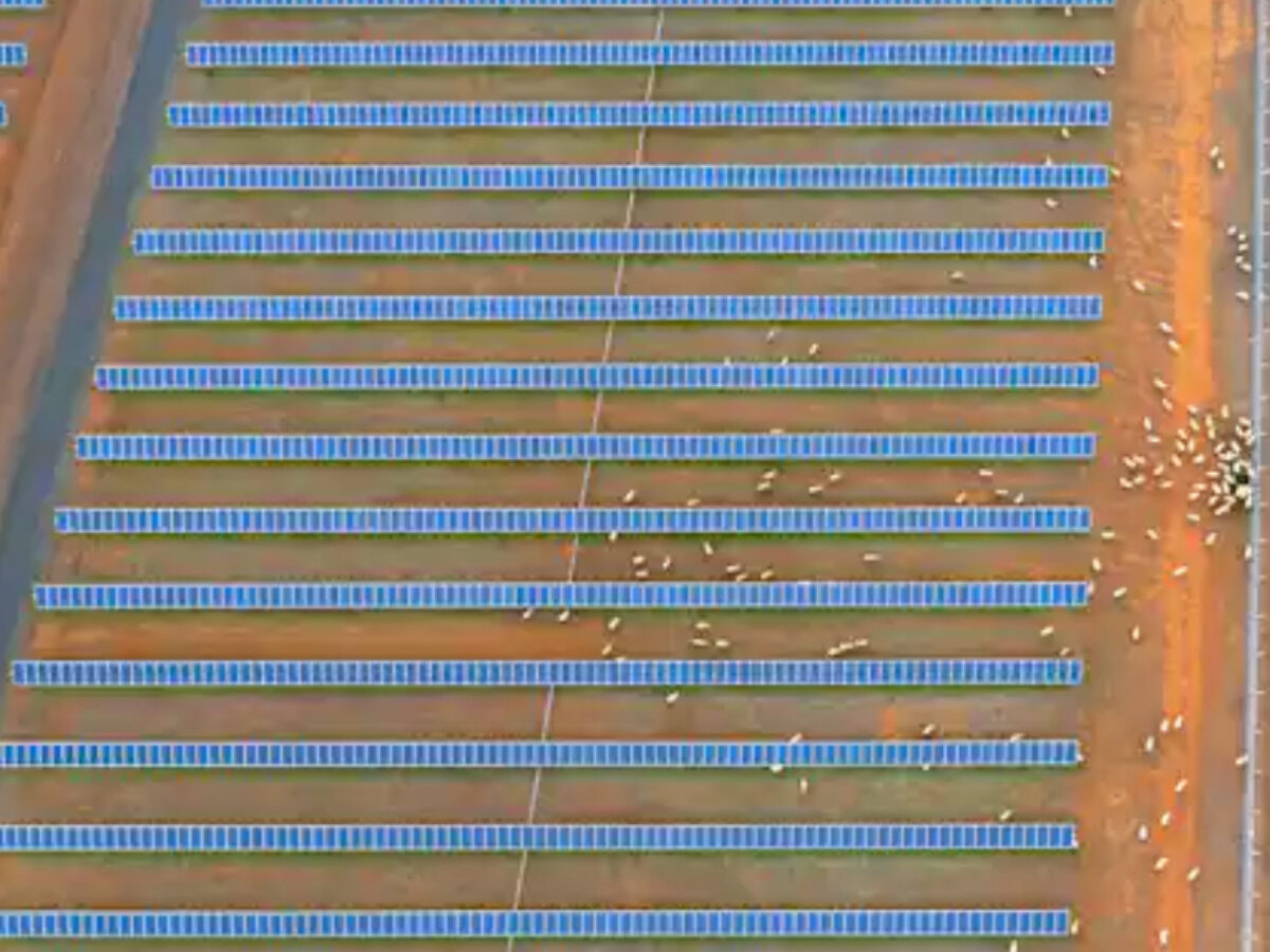

Similarly, because solar panels are spaced apart, the area spanned by a solar farm is often two to three times the actual area of the panels themselves.
The panels are typically spaced to avoid losses from shading. As an added bonus, it means rain and sunlight can fall between them, allowing grass to grow and livestock to graze and shelter.

A sheep and a lamb resting in the shade of solar panels, facing the camera
Solar panels also provide shade for livestock.
