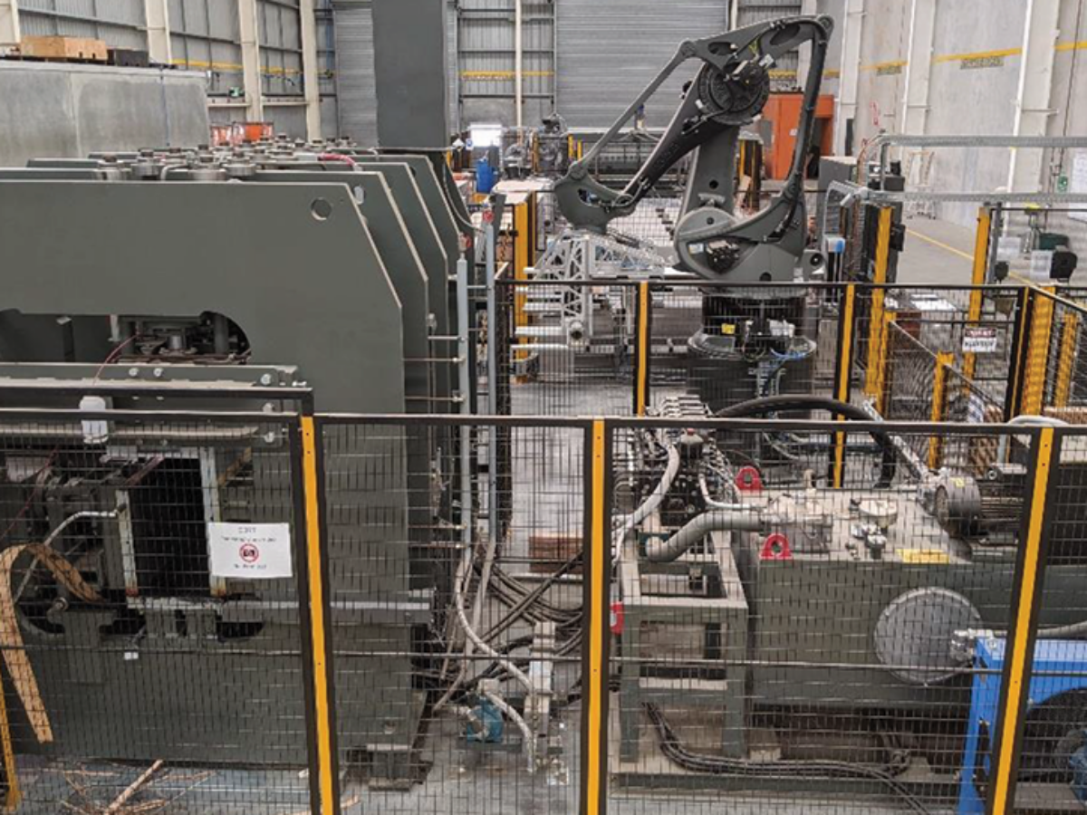

“So this concept was driving us therefore to very advanced automation. This whole line, which has the output of a traditional sawmill, is run by three people.”
Next year it plans to export its machines in partnership with Bosch, with the units feeding processing data back to 3RT’s Adelaide innovation centre to help finetune the process and make it more robust.
The two-robot cells are equipped with over 100 sensors, according to the founder, picking up information about inputs, outputs and everything in-between.
“The process is biomimicking nature, and nature is very complex. Although the machine looks simple, it is actually a very complex process to get it right,” he adds.
“To make sure that every time you run the line with one particular species or one particular input, you have the same output in terms of properties. And that's basically the basis of what we do with the algorithms and the analytics.”
