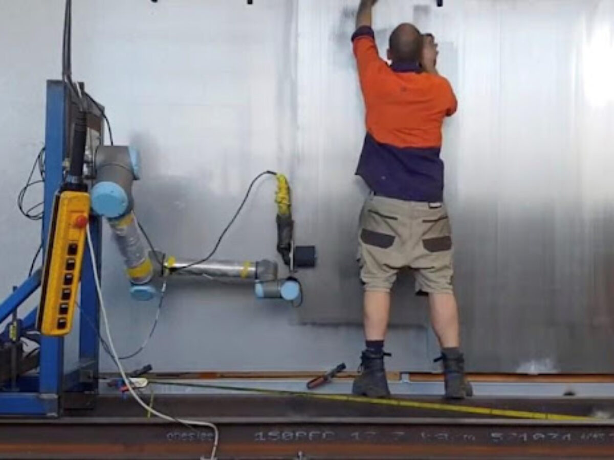

Cobots offer a low-cost, more flexible and safer alternative to the robots seen more often in traditional manufacturing settings. They do not need safety cages to keep people away and require less floor space and less infrastructure to operate. A cobot’s light payload capacity means they can be introduced in areas where previously a robot would not have been possible. One example is the food industry where they are now commonly used for picking and placing items into packaging alongside the human worker.

Picture: supplied
