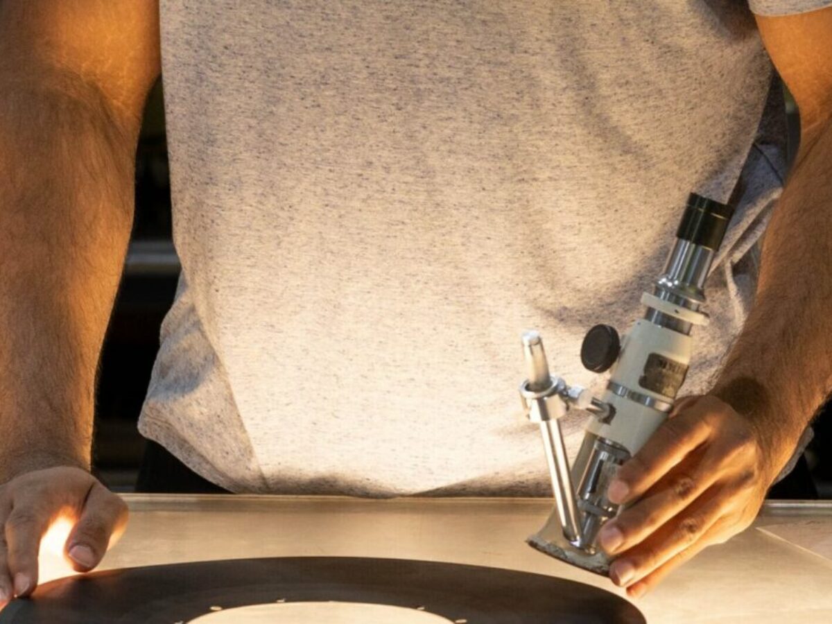

It had previously relied on manual point inspections of these holes using a microscope, before being introduced to OptoTech, a specialist in developing and building laser-based inspection systems for clients in industries ranging from semiconductors to medical devices.
David Pask, Production Manager at ActionLaser, said his company could previously measure “perhaps 100 holes on the disc and extrapolate a measure for the entire disc” but this was from about 500,000 holes on a filter “and we really wanted to qualify our work” against international competition.
