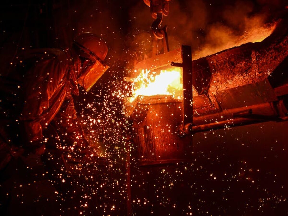

Steel workers at plant
A green steel industry would give Australia a slice of the low-emissions manufacturing boom.
Daniel Munoz/AAP
