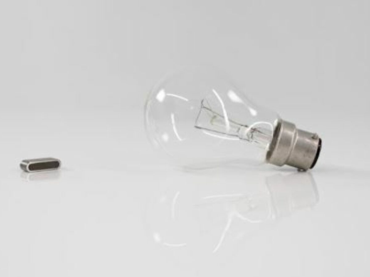

Micro-X has replaced the glass tube with a metal can, and the filament with a tiny array of carbon fibre nanotubes.
This comes together as what is still the world's only cold cathode X-Ray emitter, only 12 millimetres long and five wide (main picture, at left), which is at the heart of the company's lightweight Nano and Rover X-Ray machines.
