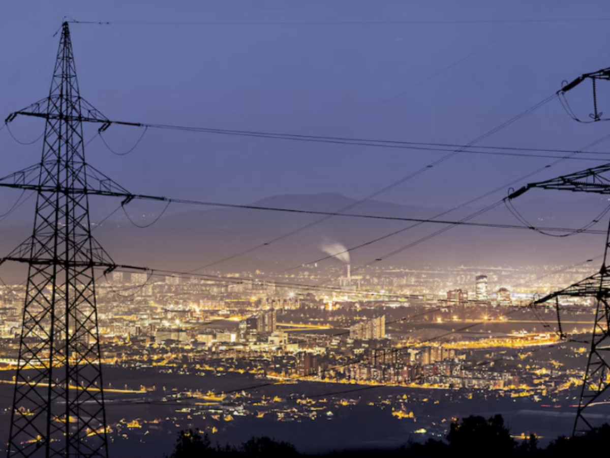

Picture: credit International Energy Agency
